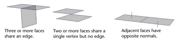

Non-manifold topology polygons have a configuration that cannot be unfolded into a continuous flat piece. Some tools and actions in Maya cannot work properly with non-manifold geometry. For example, the legacy Boolean algorithm, the Reduce feature, and Sculpting Tools do not work with non-manifold polygon topology. The image below shows three examples of non-manifold topology polygons.
This shape is also possible where two three-dimensional shapes share a vertex (such as two cubes meeting at a single point).

You can convert non-manifold topology polygons into two-manifold topology (including the less obvious case of adjacent faces with opposite normals) using Mesh > Cleanup.
