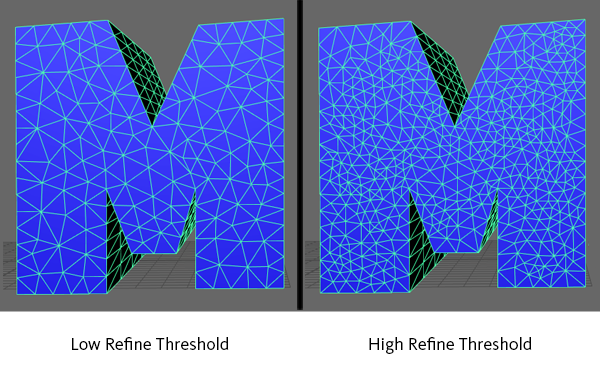

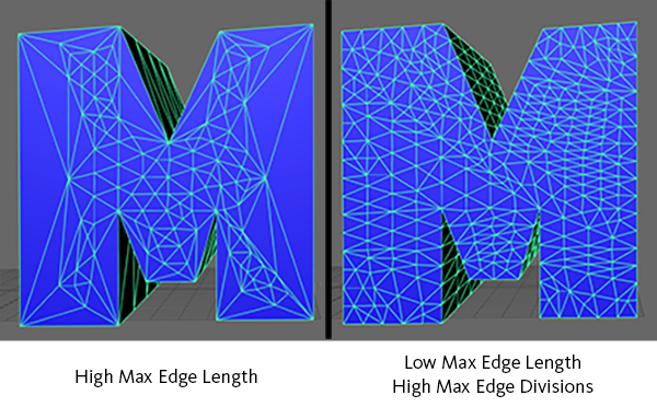

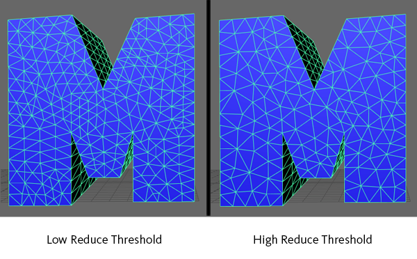

Triangulates the mesh through edge splitting and collapsing based on the attributes in the Deformable Type section.
This works by first subdividing the Type mesh along its edges (controlled via a combination of Max Edge Divisions and Max Edge Length attributes) then executing a polyRemesh operation on it. After that, the Reduce Threshold and Refine Threshold determine the layout of the subdivided caps.
Specifies the maximum number of times an edge can be divided by vertices. Default value is 20.
Splits all edges along the profile of the type mesh that are longer than the length specified here in world units. Default value is 5.
Splits all edges on the front and back faces of the Type mesh that are longer than the length specified here in world units. Mainly used to control the density of the cap subdivisions. Default value is 1.
Collapses all edges shorter than the percentage of the Refine Threshold value specified here. Mainly used to clean up the cap subdivisions. Default value is 20.
