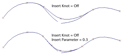

The following figures show the same blended curve resulting from two identical input curves. The top blended curve has Insert Knot turned off. The bottom blended curve has Insert Knot turned on with an Insert Parameter value of 0.3. The closer Insert Parameter is to 0, the closer the blended curve resembles the end shape of the original curves.
To adjust this option interactively, create the blended curve with Insert Knot turned on. Then select the curve, display the Channel Box, select attachCurve in the INPUTS section, and edit the Parameter option.
