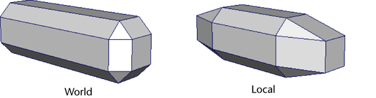

Determines whether a bevel applied to a scaled object will also be scaled in relation to the scaling on the object.
(Default) If you bevel a scaled object, the offset will ignore the scaling and use world space values.
If you bevel a scaled object, the offset is also scaled relative to the scaling applied to the object.

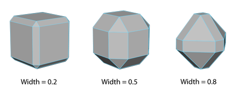

Specifies the distance between the original edge and the center of the offset face to determine the size of the bevel. The Width option is dependent on whether the Offset Type is set to Fractional or Absolute.
When the Offset Type is Fractional, the Width value is limited to a range between 0 to 1. When the Width value is 1, the distance will be the maximum possible (based on the shortest edge) that will not produce an inside-out bevel. A Width value greater than 1 will produce inside-out bevels.
When the Offset Type is Absolute, the Width value is the distance between the original edge and the offset face measured in the scene’s linear unit. This is like the radius of the bevel. A large Width value can produce inside-out bevels.

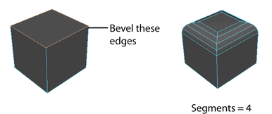

The Segments value determines the number of segments created along the edges of the beveled polygon. Use the slider or enter a value to change the number of segments. The default is 1.

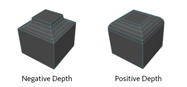

Adjusts how far edges are bevelled inwards (-) or outwards (+). The default is 1.

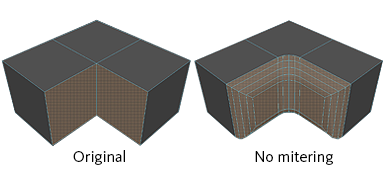

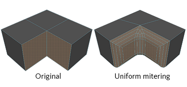

Determines how intersecting beveled edges are joined when one or more non-beveled edges is also involved.
Creates a single vertex, regardless of how many edges at the intersection are not part of the bevel operation. If there are at least two edges at the bevel intersection that aren't being beveled, Maya creates a corner. When beveling two edges that share only one non-beveled edge at the intersection, no corner polygons are created.
Similar to Uniform, but produces higher resolution corners for smoother transitions.
Similar to Patch, but produces an arc in the corners rather than connecting bevel edge vertices to non-bevel edge vertices.
Creates a new vertex on each non-beveled edge. No mitering is performed, so beveled edges are not directly connected to each other (i.e. a vertex is also created between each adjacent beveled edge).

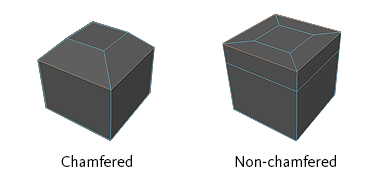

Lets you specify whether you want the beveled edges to be chamfered (sloped) or not. The default is on.

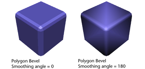

Lets you specify whether you want the beveled edges to be hard or soft when shaded.
If you want the beveled edges to be soft, set the Smoothing Angle to a high value (180). If you want the beveled edges to be hard, set the Smoothing Angle to a low value (0).
In general, if the angle between two shared edges is greater than the value specified by the Smoothing Angle attribute, the beveled edge will be shaded to appear hard. The default Smoothing Angle value is 30 degrees.
