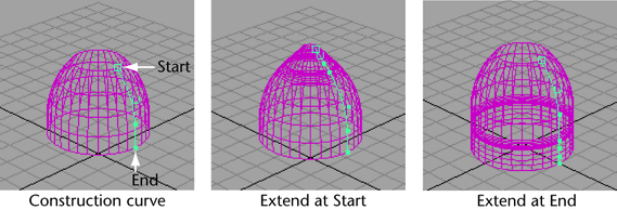

Start extends the curve from its start point.
End extends the curve from its end point.
Both extends the curve at both ends.

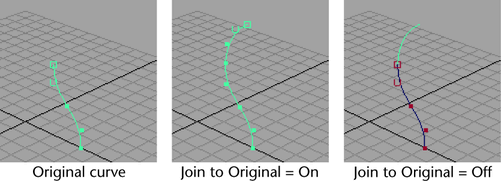

Attaches the curve extension to the original curve. If off, the input curve and the curve extension are independent objects. You can transform the extension separately.
Removes the multiple knots that Maya creates when Join To Original is turned on.
Keeps the original curve after the extension is created. If both Keep Original and Join to Original are off, the extension curve replaces the original curve.
