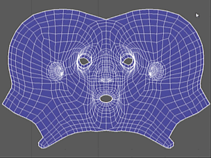

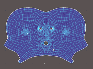

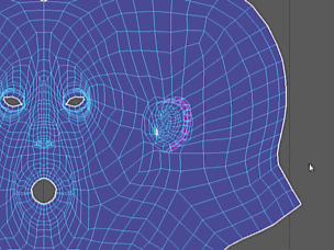

Grab Tool, Pinch Tool, Smear Tool, and Symmetrize Tool.
To alter UVs by dragging over them
| Tool | Effect | Example |
| Pulls UVs in the same direction that the mouse is dragged.
This works similarly to the Smudge UV Tool. |
| Pulls UVs toward each other. |
| Pushes UVs tangent to their original position in the direction that you stroke. |
| Symmetrize UV Tool | Moves UVs to a position opposite corresponding UVs across a chosen axis. |
