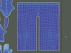

Straighten a selected edge loop and then unfold around it
- Select a UV or edge loop.
- In the
UV Toolkit, open the
Unfold section.
- Click
Straighten Shell.

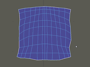

Straighten a UV border
- In the
UV Editor, select the UVs around the tangled UV border.
It doesn’t matter if you select interior UVs along with border UVs.
Straighten UV Border only acts on the borders.
In some cases, it is difficult to select the UVs you want to straighten without selecting other UVs you want to leave unaffected. In these cases, you can leave a gap in your selection and use the
Fill Gaps in Selection option to straighten the UVs you could not select.
- Select
(or alternatively,
in the main menu bar).
- Select the polyStraightenUVBorder node and edit the attributes in the
Attribute Editor or
Channel Box.
