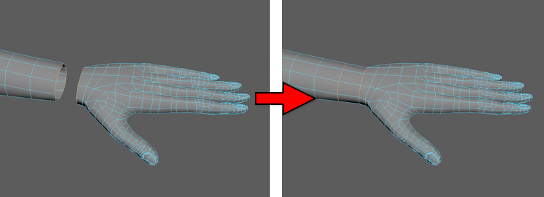

You can construct faces between pairs of border edges using the Bridge command. The resulting bridged faces are merged into the original mesh. Bridge is useful when you need to connect two sets of edges together with a piece of mesh. For example, connecting and merging the wrist on a character’s arm to its hand.
