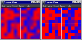

Switch between blended and sharp-edged pixels. |
In the UV Editor, click the Toggle Filtered Pixels button on the toolbar or select Image > Unfiltered. ![]() |
