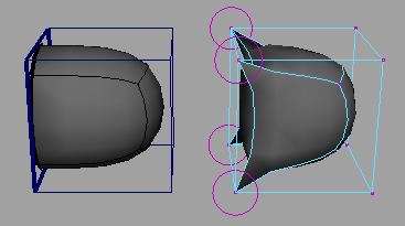

Applying creases to components modifies your polygonal meshes so you can create shapes that transition between hard and smooth, without increasing the resolution of the base mesh.
Creases are measured by a crease value, which indicates the amount that each level of a subdivision is creased. The higher the crease value, the sharper the crease. For example, a crease value of 2 means that the base level and first level edges are fully creased, but finer level edges are not creased at all.

Edges that have creasing applied appear with heavier lines on the original mesh. Vertices with creasing applied are indicated by a small circle encompassing the vertex.
