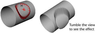

Select Push, Pull, Smooth, Relax, Pinch, Slide or Erase. A letter appears within the brush stamp to reflect the operation: Ps (Push), Pl (Pull), Sm (Smooth), Re (Relax), Pn (Pinch), Sl (Slide) or E (Erase).
