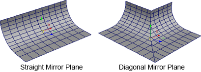

The Mirror command allows you to create a duplicate of a mesh that is reflected across an invisible mirror plane. You can then position this plane manually to customize and tweak the resulting geometry. Use the following options to set what happens when you select Mesh > Mirror.

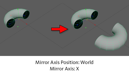

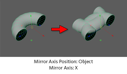

Specifies the plane of symmetry on which to mirror the selected polygon object. Default is World.
Specifies the axis on which to mirror the selected polygon object, centered at the Mirror Axis Position. Default value is X.
