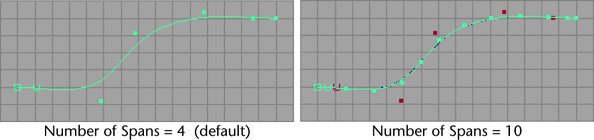

Specifies the number of spans in the resulting curve.

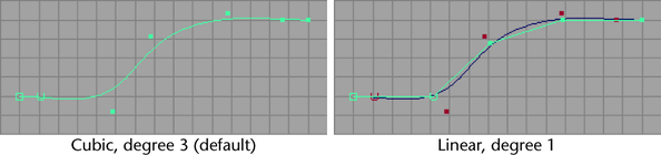

The higher the Degree, the smoother the curve. The default setting (3 Cubic) works well for most curves.
