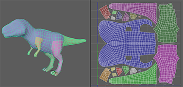

Affects the randomization of colors when Color Mode is set to Multi-Color.

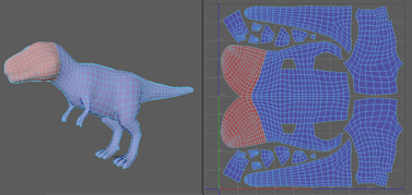

Specifies the shaded color for UV shells with a clockwise winding order when Color Mode is set to Front & Back Facing. The default color is blue.
Specifies the transparency value for the front-facing shaded UV shells when Color Mode is set to Front & Back Facing. A value of 0 is fully transparent while a value of 1 is fully opaque. The default is 0.25.
Specifies the shaded color for UV shells with a counterclockwise winding order when Color Mode is set to Front & Back Facing. The default color is red.
Specifies the transparency value for the back-facing shaded UV shells when Color Mode is set to Front & Back Facing. A value of 0 is fully transparent while a value of 1 is fully opaque. The default is 0.25.
