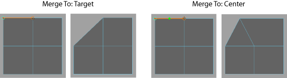

Use these options to set what happens when you use the Target Weld Tool. Click and drag a vertex or edge to the target to merge all selected vertices or edges. For more information on how to use this tool, see Merge polygon components.

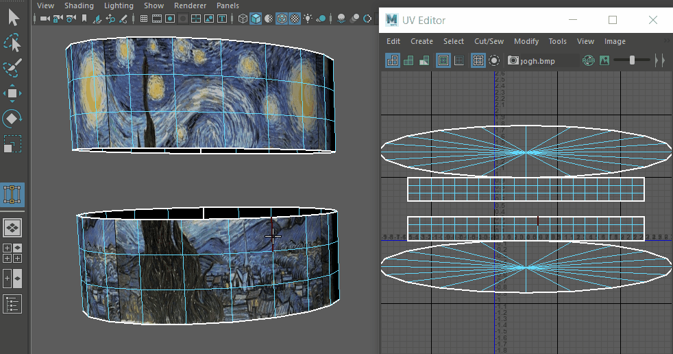

Showing Target Weld on a primitive with and without the preserve UVs option activated.
