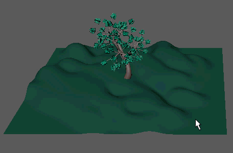

MASH Placer allows you to place or modify points in your scene by dragging the mouse cursor over existing surfaces or points respectively.
You can place points in the following ways:
- Drag over an object to place points onto its surface.
- Hold M + drag to precisely place, rotate, and scale a point.
- Shift + drag over existing points to scale them up.
- Ctrl + drag over existing points to scale them down.
- Hold J + drag over existing points to align them to the brush stroke.
Like all brushes, you can also hold B + drag to adjust the brush size or hold N + drag to adjust the brush strength.
