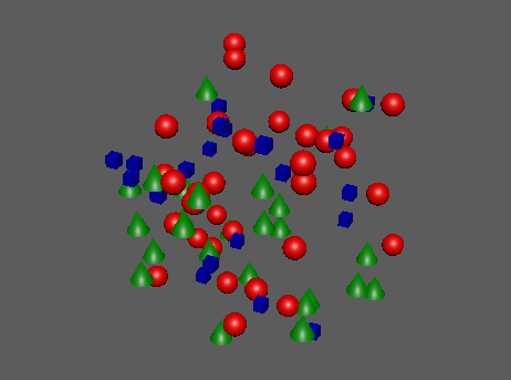

Allows you to assign different objects to MASH points.
Note: Should be added to the Instancer's ID channel.
ID Node
ID Type
The type of ID distribution. Options include:
- Linear: Increments the ID of each object by 1. Loops if there are not enough objects.
- Random: Each object gets a random ID. You can adjust the probability of certain IDs of certain IDs showing up over other IDs using the
Probability Ramp.
- Cycle: IDs are incremented per frame.
- Fixed: Each ID is the same.
