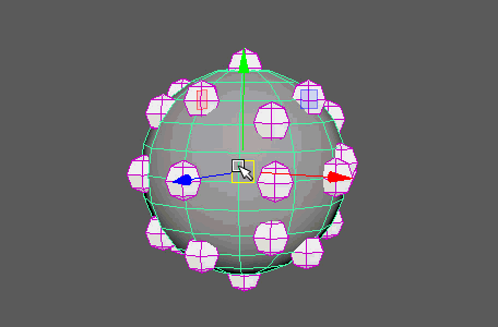

Offsets the points of a MASH network on a point by point basis.
Mass
Mode
Specifies how to apply the offset. Options include:
- Offset: Adds to the
Offsets to the input array.
- Multiply: Multiplies the
- Overwrite: Values will be set to these regardless of incoming values.
- Closest Point On Mesh: Points will offset to the nearest spot on a specified mesh.
- Multiply by Time: Multiplies the offset values by the frame number and adds the result to the input array.
Transformation Space
Determines whether to transform points relative to their shared
World space or their individual
Local spaces.
Enable Position,
Enable Rotation,
Enable Scale, Enable Id
Determines which transforms are affected by the offset operation.
Offset Position,
Offset Rotation,
Offset Scale
Sets the offset value to be applied to each transform.
Clamps (Normal mode only)
Defines lower and upper bounds for the node's output. Any values below or above these values returns the respective clamp value instead.
Low Clamp
- Defines the lower bound of the clamp.
High Clamp
- Defines the upper bound of the clamp.
Multiply By Time
The following options only have an effect when
Mode is set to
Multiply by Time.
Start frame
- Offsets the starting frame of the
Multiply by Time operation.
Closest point on Mesh
Mode is set to
Closest Point On Mesh.
Input Mesh
- Displays the current mesh being used as input. You can assign the currently selected object either by middle-dragging it to this field or by right-clicking the field and clicking
Connect.
Closest Point Mode
Closest Point on Mesh moves all points in the network to the closest point on the
Input Mesh.
Ray Cast shoots a ray from each point in the
Ray Direction, then moves the point to the spot on the
Input Mesh where it intersects (if one exists).
Ray Direction
Closest Point Mode is set to
Ray Cast.
Hide on Ray Miss
Hides points whose rays miss the
Input Mesh. Useful for turning off objects that fall off the mesh.
Reorder Points
Mode
- Allows you to reorder your points based on a number of different criteria. These include:
- X: Reorders points along the X-axis from negative to positive.
- Y: Reorders points along the Y-axis from negative to positive.
- Z: Reorders points along the Z-axis from negative to positive.
- Distance to Point: Reorders points based on their distance to the point specified by Distance Point.
- Distance to Mesh: Reorders points based on their distance to the mesh specified by Distance Point.
- Random: Reorders points randomly.
Reverse
- Inverts the current point order.
Random Seed
- Changes the randomization when
Mode is set to
Random.
Distance Point
- Sets the relative point when
Mode is set to
Distance to Point.
Distance Mesh
- Sets the relative mesh when
Mode is set to
Distance to Mesh.
Strength
Strength
- Fades the node's effect for all the objects at the same time.
Random Strength
- Smoothly fades the node's effect on all the objects in a random order.
Step Strength
- Turns the node's effect off one object at a time.
Filter On,
Filter Off
- Allows you to customize which instances are always / never affected by this node.
Strength Map
- Determines the input file (2D texture, animated texture, etc) that controls the shape of the node's effect.
Map Projection Axis
- Determines the axis along which the
Strength Map is projected.
Map Helper
- Displays the object being used to interactively place the
Strength Map in the scene. You can right-click the field to create a new helper object (a plane) if none exists. You can also middle-drag a mesh into this field or right-click to connect a selected mesh. If a mesh is already connected, you can also right-click to break its connection or show it in the Outliner.
Note: For the best results, assign the same texture to both the
Strength Map and the
Map Helper (this automatically happens when creating a new helper object).
Per Point Adjustments
Map adjusts Offsets
- Sets the
Strength Map to affect the
Offsets values rather than the
Strength value.
