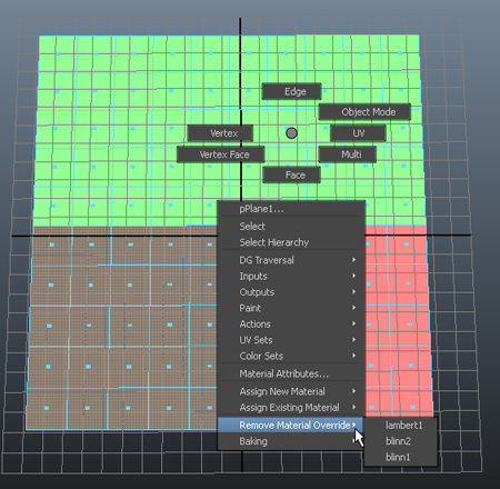

To remove a material override from an object in a render layer: method 1
- In the
		  Render Layer Editor, select the render layer in which you want to remove a material override.
- In the scene view, right-click the object and select
		  Remove Material Override. A list of material overrides for the selected layer appears in the menu.
- Select the material override that you want to remove.

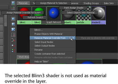

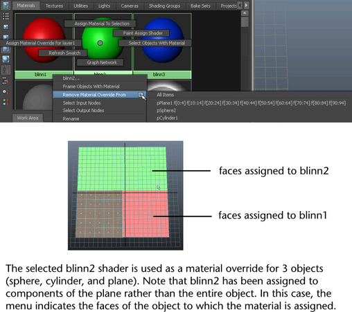

To remove a material override from an object in a render layer: method 2
- Open the
		  Hypershade (Window > Rendering Editors > Hypershade) to see the material swatch for the material override that you wish to remove.
-  Right-click the material swatch and select
		  Remove Material Override From. The menu lists all objects in the layer that use the material override.
- Select from the list the object for which you want to remove the material override.
		  If a material is currently not used as a material override, the menu displays "There are no objects with override" when you right-click a material swatch and select
		   Tip: The contents of the menu are also useful if you need to query whether a material has been used as an override, or the names of the objects for which it has been assigned as an override.
