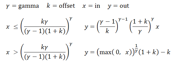

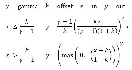

| "basicFwd" | Applies the power law with the gamma value specified in the GammaParams element. The GammaParams element must not have an offset attribute.
| "basicRev" | Applies the power law with the inverse of gamma value. The GammaParams element must not have an offset attribute.
| "moncurveFwd" | Applies a function that has a linear segment near the origin (black) and a power-law segment at higher values. At the junction, the curve is continuous in both value and tangent. This type of curve is used in the Rec. 709, sRGB, and CIE L* equations.
						 The GammaParams element must have an offset attribute.
| "moncurveRev" | Applies a function that has a linear segment near the origin (black) and an inverse power-law segment at higher values. The GammaParams element must have an offset attribute.
