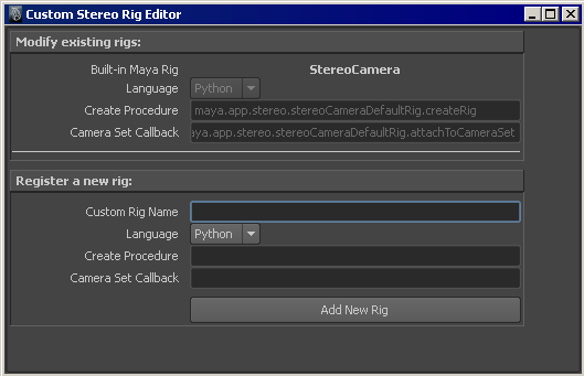

Registering your custom rig
The Custom Stereo Rig Editor window appears.
maya.app.stereo.stereoCameraComplexRig.createRig.
