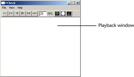

FCheck displays two windows. The FCheck Playback window displays images or sequences you open. Depending on the platform, the menu items in the Playback window are different.
