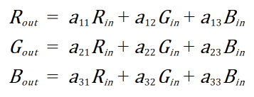

3×3 Matrix Multiplication

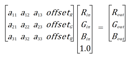

3×4 Matrix Multiplication

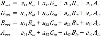

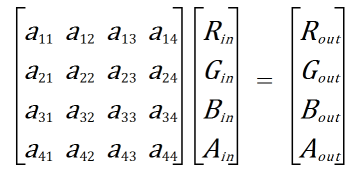

4×4 Matrix Multiplication

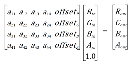

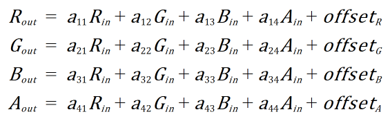

4×5 Matrix Multiplication
| Value | Meaning |
| "3 3 3" | A 3×3 matrix operating on RGB values. |
| "3 4 3" | A 3×4 matrix operating on RGB values.  Introduced in version 1.3.  |
| "4 4 4" | A 4×4 matrix operating on RGBA values.  Introduced in version 1.3.  |
| "4 5 4" | A 4×5 matrix operating on RGBA values.  Introduced in version 1.3.  |
