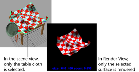

You can isolate specific objects to render. Note that when using IPR rendering, you must perform another IPR render before you can see the effect of this change.
To render selected surfaces
Render the scene.
In Render View, select Render > Snapshot and select the camera (view) you want to capture.
