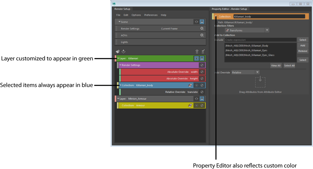

By default, render setup nodes (layers, collections, and overrides) appear in grey in the Render Setup editor, but you can change any of them to a different color for better visibility and organization.
Right-click any layer, collection and override and select the Label Colors menu to choose from a list of six available colors, such as red or blue. The Property Editor also reflects the custom color setting.
To reset the item to its default grey color, select Label Colors > No Color.
Selected render setup nodes always appear in blue in the Render Setup editor, regardless of their color setting.
