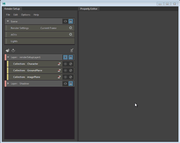

Click the
Scene
icon at the top of the
Render Setup editor to switch to the scene layer, then double-click the
Render Settings tab to open the
Render Settings window. This opens the
Render Settings for your scene.
The range of frames being rendered is also displayed. It may indicate Current Frame, or Frame 1-10, for example, if you have set a Start frame and an End frame.
Double-click the Render Settings tab on the scene layer (or on any of the render layers) to open the Render Settings window.

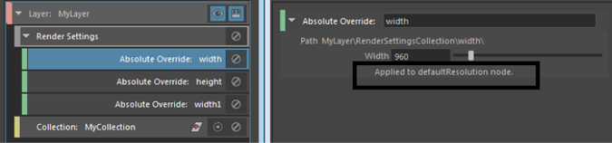

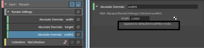

Select any Render Settings override, and the Property Editor indicates the node to which it is applied; for example: Applied to defaultResolution node. This indicator appears on all Render Settings overrides created since Maya 2017 Update 3.
This indicator may be helpful in cases when you create overrides on two or more attributes with the same name on different nodes.
For example, in this case, there are two overrides named width. The Property Editor indicates Applied to defaultResolution node for the former:
and Applied to defaultArnoldFilter node for the latter for easy identification.

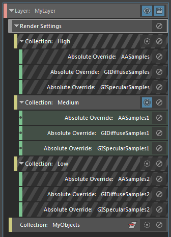

Create Render Settings subcollections to sort your overrides and create multiple Render Settings combinations.
Right-click the Render Settings collection for your layer and select Create Render Settings Collection. You can then drag and drop, or copy and paste your Render Settings overrides to this subcollection.
If a Render Settings collection does not yet exist for the layer, you can middle-mouse drag and drop the Render Settings tab from the top of the Render Setup editor to your render layer.
In addition, you can create a Render Settings override directly within a subcollection by doing the following:
on the render layer for which you want to create an override.
An example application of this feature is to create High, Medium and Low Render Settings, and convert one set of these settings (Medium, for example) to local render overrides. This way, lower sampling values are used for interactive test renders and higher sampling values (global Render Settings) are used for batch rendering.
