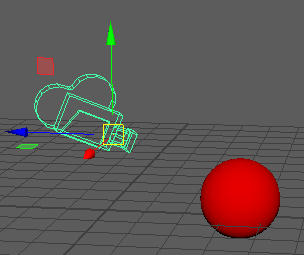

You can also create your own cameras to view your scene in different ways. See Maya camera types for a description of the kinds of camera available.

		  The Create Camera Options for that camera type appear.
