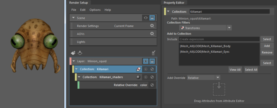

In this example, each of the squid body and eyes are connected to a blinn shader, the color attribute of which is connected to a file texture. Select Relative from the Add Override drop-down list and drag and drop the Color attribute from the blinn Attribute Editor to the Property Editor.
A shaders subcollection is created, along with the Relative override.

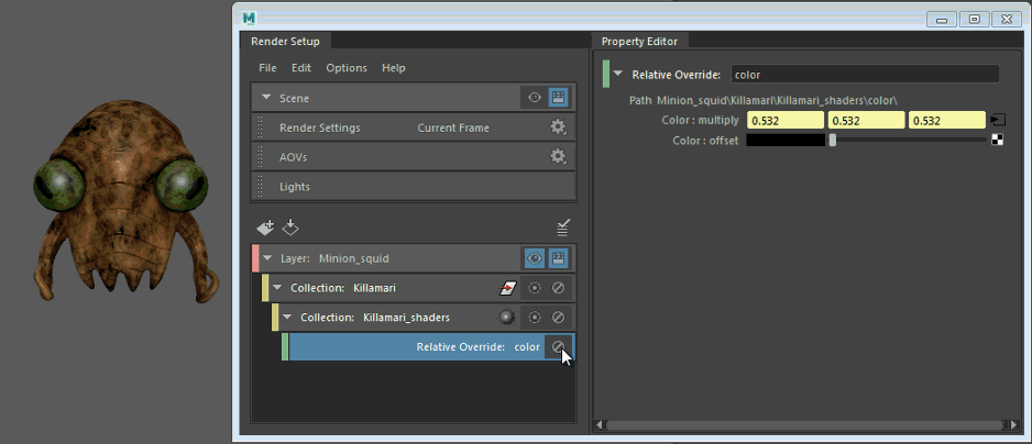

Select the relative override. Click the
button beside the multiply attribute and connect to a texture; for example, Fractal.
Enable or disable the override to switch between two shading networks. In addition, you can drag the slider beside the offset attribute to adjust the intensity of the shading.
