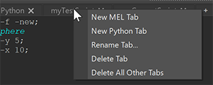

Do one of the following:
Select the option you want from the Tabs menu.
Right-click a tab and select from the available options.
Right-click either the input or history pane, and select the option you want from the marking menu.
Use hotkeys. See the Tabs section in Script Editor menus and hotkeys.
