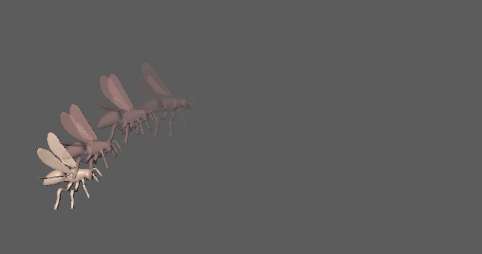

Ghost an object
Ghost objects let you see how an animation moves through a scene. Unlike Motion Trails, which simply use a line to illustrate where an animated object moves, a ghost object shows a semi-transparent representation of the object at the points in time you specify.
The opacity and the color of ghosts make it easy to differentiate between the individual frames of your animation. By default, the opacity gradient ramps down linearly from the ghost closest to the current frame to the ghost farthest away. You can adjust the ghost opacity and color using options in the Attribute Editor.

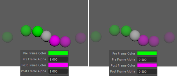

To change the color of ghosts
  1. Select the object and do the following:
    • In the Attribute Editor, select the shape node, expand Display > Ghosting Information, and select a color in the Pre Frame Color and Post Frame Color fields.
    Note: The Pre Frame Color and Post Frame Color affect deformed mesh ghosts, letting you easily identify the frames before and after the current frame based on the selected colors.
To change the opacity of ghosts
  1. Select the object.
  2. In the Attribute Editor, select the shape node.
  3. Select Display > Ghosting Information.
  4. Adjust the Pre Frame Alpha and Post Frame Alpha values.
    The Pre Frame Alpha controls the maximum opacity of the ghosts before the current frame, and the Post Frame Alpha controls the maximum opacity of the ghosts after the current frame.
    By default, the minimum ghost opacity is fixed at 15% (0.15). In the following examples the Pre Frame Alpha and Post Frame Alpha is set to 1 and 0.5.
