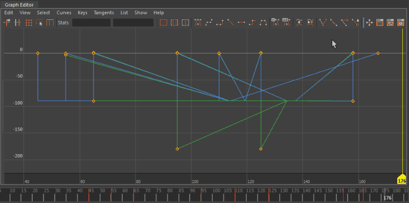

- Middle-click in the
Time Slider.
- Hold down the K key and middle-drag horizontally in any view.
Your scene does not update, but the Current Time Indicator moves to show your new current time. This is useful, for example, if you want to key an object at some frame based on a prior position of other objects. For more information, see
Time Slider.
Note:
- The K key operations work the same in all Maya windows that display a timeline, for instance, the
Graph Editor.
