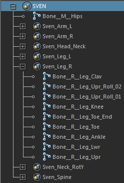

For example, in the following figure, the set SVEN is selected in the Outliner.
You can middle-drag the SVEN set, drag, and drag it into the Time Editor Roster.
The Time Editor creates a new group in the Roster and a clip in the time view.
The new group contains all objects in the set, populated hierarchically. That is, the Time Editor creates a hierarchy of clips based on the hierarchy of sets (so nested sets will appear as hierarchy of group clips), but any non-set contents of each set will still be populated into individual clips.
For example, If a set contains another set and some objects, a group clip is created, inside of which there are clips for the inner set as well as objects of the outer set. If the inner set contained even more sets, then it will be imported as a group clip as well, with clips inside the inner-most set.
