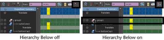

Hierarchy Below
Use Hierarchy Below to toggle the display of objects acting as summary objects for objects beneath them.
For example, in the following diagram, a cone with a Translate X channel is under a group with no animation on it. With Hierarchy Below on, the group1 node acts as a summary group and displays the animation information of its child node (the cone). With Hierarchy Below off, only the summary objects (Dopesheet Summary, Scene Summary) display summary information.
