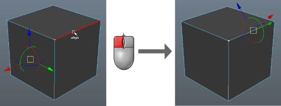

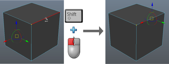

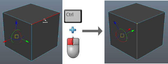

To change the pivot point
The custom pivot manipulator (the translate and rotate manipulators combined) appears. If you're modeling in component mode, multi-component selection mode activates.
You can reset a modified pivot's position/orientation at any time by right-clicking the scene and selecting any of the Reset Pivot options (only in Custom Pivot mode).
