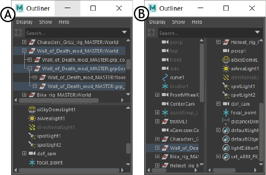

Outliner split views A. Horizontal, B. Vertical
