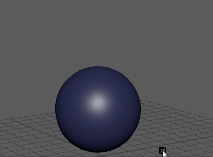

Objects in Maya are geometric shapes, like the sphere in the example above. Components are a way of breaking down an object into parts, such as:
A sphere in object mode: right-click to select its different components

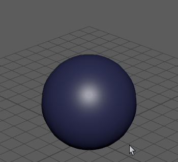

Flip back and forth between Object and Component modes by pressing F8. A message appears in the viewport to let you know that you have changed modes.
Press F8 to switch between selection modes
