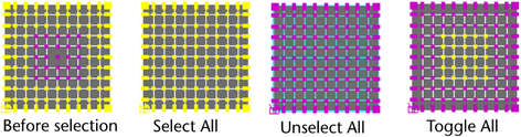

Select All
Selects all components on the selected surface(s).
Unselect All
Unselects all selected components on the selected surface(s).
Toggle All
Selects all unselected components and unselects all selected components on the selected surface(s).
