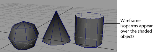

Wireframe on Shaded
Superimposes a wireframe display on all shaded objects in a view.
