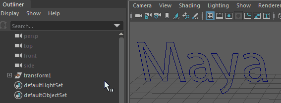

Importing Illustrator EPS files
Before starting make sure that your .eps file is save in Adobe Illustrator 8 format.
- Select
- Choose
EPS from theImport Options File Type menu.
- Select an .eps file and click
Import.
The EPS file is imported as
Transform1. To select it, click it in the Outliner.
