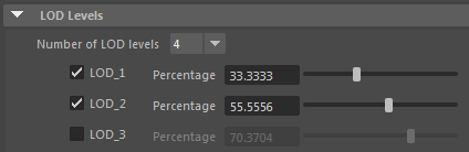

  3. In the Generate LOD Meshes Options, set the following options to determine how your high resolution mesh gets reduced to generate the lower level resolution meshes:
    • Specify whether you want to copy skin weights from the selected mesh to the new meshes. (Enable or disable the Copy skin weights check box.)
    • Set the Reduction Method to reduce the number of polygons by percentage, vertex, or triangle count. (In this example, we use Percentage.)
    • Specify the Number of LOD levels you want to create, and enable the check box for each one in the list.
    • Set any other shape and preservation options you want. (See Generate LOD Meshes Options for details.)
