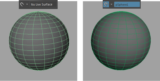

  1. Select an object in your scene.
    Note: The live surface can be a polygon mesh, NURBS surface, or construction plane. Make Live also supports hidden surfaces.
  2. Do one of the following:
    • Right-click the object, and then select Make Live from the pop-up menu.
    • Select the Make Live icon in the Status Line.
    • Select Modify > Make Live.
    The selected object becomes a live surface and its name displays beside the Make Live icon in the Status Line. A live surface's wireframe color is dark green, but it only displays when Wireframe or Wireframe on Shaded mode is enabled.
