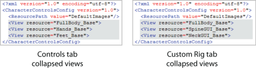

The configuration files are built around the views in the Controls tab (Full Body, Hands, and Feet) and the Custom Rig tab (Full Body, Spine, and Neck):
