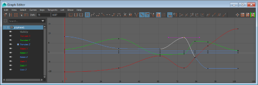

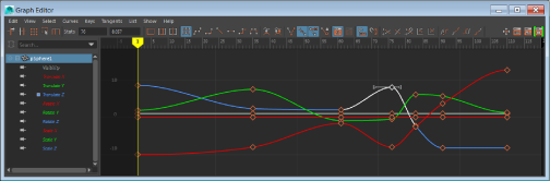

Default tangent weight represents the amount of influence a tangent has on an animation curve segment. Select between Weighted or Non-weighted:
Weighted tangents
Weighted tangents: you can change angle and length
Weighted tangents have long handles that let you edit the influence and angle of the tangent quickly and intuitively, similar to Bezier-style behavior in vector-based graphics software. Weighted tangents let you manipulate both tangents on a key, keeping the arc of the curve balanced on both sides.
Non-weighted tangents
Non-weighted tangents: you can change angle but not length
Non-weighted tangents have simple handles that only control the tangent's angle.

Graph Editor
Snap Value to Adjacent Keys
When on (default), neighboring keys with similar values automatically align as you edit curves in the Graph Editor. Enable this preference if you want similar, adjacent keys to snap to identical values.
Left Mouse Button Alters Selections
Note: This behavior is available only in the Classic Graph Editor.
When on (default), you can drag to move selected keyframes in the graph view area with a single click. When off, clicking selected keyframes has no effect in the graph view area, and you must select the Move tool and middle-drag to adjust keyframes. Enabling this option may be preferable if you are familiar with keyframe editing workflows in other Autodesk applications, such as MotionBuilder.
Stacked View Spacing
Widen or narrow the horizontal "lanes" that stacked curves display in the Stacked view. .2 is the default.
Auto Frame
Automatically adjusts the graph view to fit the display of the animation curve associated with a selected object or objects. This option only adjusts to fit the y-axis view. To frame both x- and y-axes, activate this option and the Auto Frame both Axes option, below.
Auto-frames the graph view in both the x (time) and y (value) axes. This option is only available if the Auto Frame option (above) is activated.
Tip: You can activate both this and the Auto Frame options from the Graph Editor View menu.
Key Size
Lets you control the size of the keys shown in the Graph Editor Graph View. Key size is percentage of the original key size (100% or a value of 1). You can scale keys between 40% (0.4) and 200% (2).
Tip: Use the following command to exceed the default size settings: animCurveEditor -edit -keyScale 0.8 graphEditor1GraphEd;
Graph Editor UI
Switch between the Classic or Modern User Interface.
Note: You must close and reopen the Graph Editor for these changes to take effect.
Classic Graph Editor UI
See Classic Graph Editor for menus and features associated with the Classic Graph Editor UI.
Modern Graph Editor UI
See for menus and features associated with the updated Graph Editor UI.
