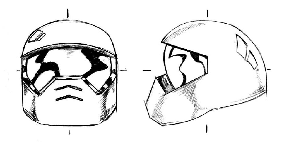

HelmetFront.jpg appears in the front view and depicts a drawing of the helmet.
HelmetSide.jpg appears in the side view.
The front and side images for this lesson were created so that the two views are aligned and the height of each image is identical. When you import them as image planes, they appear at the same scale. These are important considerations when you construct your own reference images in the future. Otherwise, your reference images may not align or may be at different scales between the two orthographic views.
By referring to the image planes in the orthographic views as you work, you can correlate how a feature in one view, appears in another. While a top view reference image is useful in many cases, it isn’t critical for this lesson.

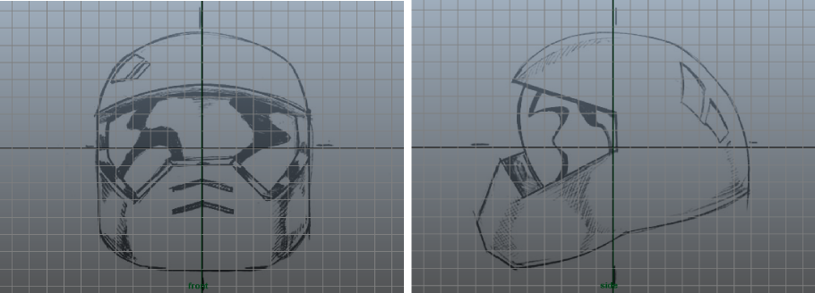

The image planes can be set so they appear partially transparent to allow you to work with the polygonal components more easily. To do this you’ll select the front and side orthographic cameras and modify the transparency of the images.
To modify the transparency of the reference images
The Attribute Editor displays the attributes for the front reference image.
The image appears partially transparent.
You can change the Alpha Gain at any time if you want the image planes to appear more or less transparent.
You can also set the reference images to only appear in the front and side cameras.
