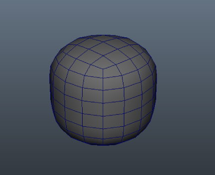

To display the helmet mesh in Wireframe on Shaded mode
This changes the selection mode to Objects.
The helmet mesh displays in smooth shaded mode.
The wireframe appears on the mesh as well as the shading (whether or not the mesh is selected).

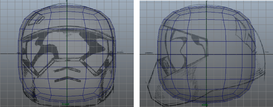

The opacity of the smooth shading in the side and front views prevents you from seeing the image planes behind the object. X-Ray display mode solves this problem by making the smooth shaded surface appear semitransparent.
To display the helmet mesh in shaded X-Ray mode
The helmet mesh updates to a semitransparent shaded display with the wireframe. You can see the 2D image behind the mesh.
After setting the shading for the objects in the various views, you may wish to adjust the Alpha Gain setting on your image planes to change their transparency.
