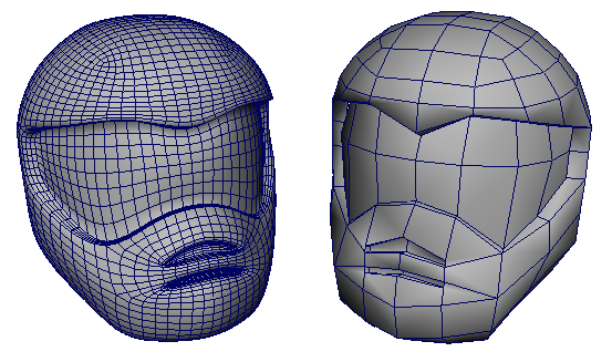

Polygon surfaces are a network of three-or-more sided flat surfaces called faces that get connected together to create a poly mesh. Polygon meshes are comprised of vertices, faces, and edges.
The wireframe lines on the mesh represent the edges of each face. The regions bounded by the edges are faces. Where the edges intersect each other is the location of a point called a vertex.
When a polygon mesh is rendered, its edges can be set to appear hard or smooth. As a result, polygons can easily represent both flat as well as curved 3D forms. You’ll work with these component types continuously when modeling with polygons.
Polygonal surfaces have a wide range of applications and are the preferred surface type for many 3D applications including interactive games and web development applications.
Polygonal surfaces can be described with the smallest amount of data of all the 3D surface types, and therefore, can be rendered quickly, delivering increased speed and interactive performance to the end user in games and other applications.
