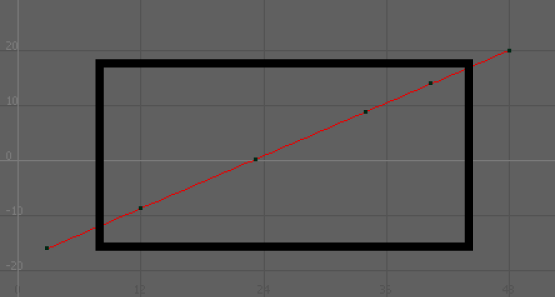

In addition to static channels, you’ll often create excess keys—keys that aren’t being used to control the shape of a curve. Whenever you see three key points that lie in a straight line, the one in the middle is unnecessary. For example, in this lesson’s original Translate X curve, there were four redundant keys:
When you remove redundant key points, the shape of the curve doesn’t change and you speed up Maya processing.
