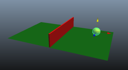

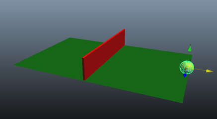

In the following steps, you use keyframes to set the starting and ending positions of the ball’s movement.
To set beginning and ending keyframes
This sets a key at frame 1 for all transform attributes of the ball. Transform attributes are the X, Y, Z move attributes. Although you animate only the translate X and Y attributes of the ball in this lesson, keying all transform attributes saves you time having to choose specific attributes to be keyed.
In the Time Slider, notice the red marker at frame 1, known as a tick. This tick appeared when you set the key for frame 1. With the ball selected, ticks in the Time Slider indicate where you’ve set keys.
From the two keys you’ve set, Maya creates motion between the positions. By default, the animation plays in a loop from frame 1 to 72. The ball travels through the fence at this stage.

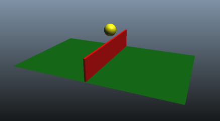

To make the ball fly over the fence rather than pass through it, you need to position the ball above the fence and set a key there.
To set intermediate keyframes
Throughout this lesson, tumble the perspective view or examine a front view to make sure the positioning is correct.
The ball now flies off the ground, over the fence, and back to the ground in a smooth arc between the keyed start, middle, and end positions.

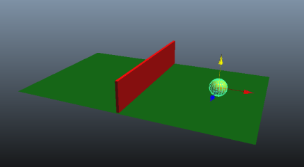

In the next steps, you’ll set keys to bounce the ball in the middle of the right half of the ground.
To set keyframes to make the ball bounce
