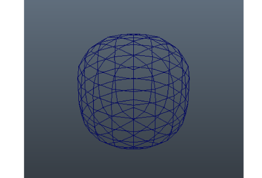

You can smooth the cube so it appears more rounded on the corners and subdivide it into smaller faces using the Smooth feature.
To smooth and subdivide the cube primitive
The cube primitive is smoothed and is rounded at its corners. The cube has also been subdivided into smaller faces.
The polygon faces are still four-sided even though their shape and position have been modified by the smooth operation.

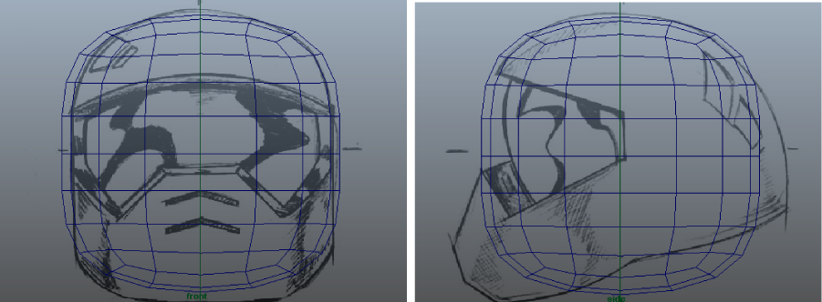

If the top, domed portion of the smoothed cube doesn’t roughly match the helmet sketches as indicated in the image below, scale both images with the Scale Tool to make it match. Do not scale the cube, as later steps will provide numbers based on the cube's current size.
