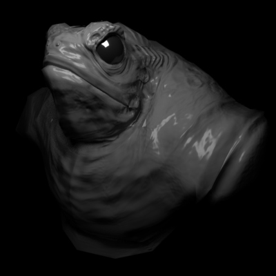

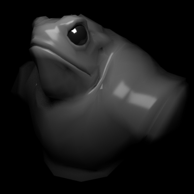

Both of the above images were rendered using the same model. The one on the right is using a normal map. If you look closely at the edges of the model, you'll see they are identical. Normal mapping is a technique in which you use a high resolution mesh to generate a map for a low resolution mesh. High resolution meshes are made of more complicated geometry and can be very taxing in an environment where resources are at a premium (for example, in a large scene with other high poly objects, or on a system with limited processing power). As a result, performance can suffer greatly. Normal mapping is commonly used in these situations to capture the detail of a high resolution mesh with the geometry of a low resolution model.
